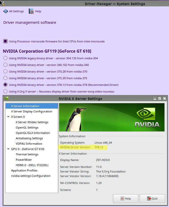

Graphics:  Card-1: Intel Xeon E3-1200 v3/4th Gen Core Processor Integrated Graphics Controller bus-ID: 00:02.0
         Card-2: NVIDIA GF119 [GeForce GT 610] bus-ID: 01:00.0
         Display Server: X.Org 1.18.4 drivers: nvidia (unloaded: fbdev,vesa,nouveau)
         Resolution: 1920x1080@60.00hz
         GLX Renderer: GeForce GT 610/PCIe/SSE2 GLX Version: 4.5.0 NVIDIA 378.13 Direct Rendering: Yes

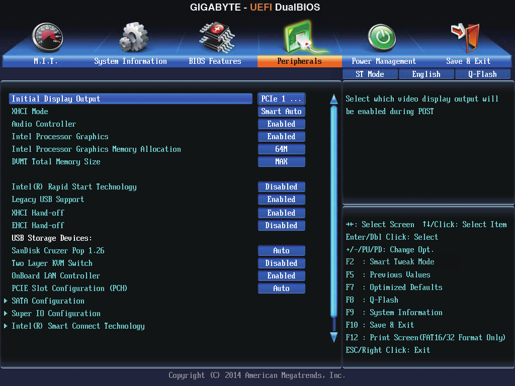

RE: Tower's 1st [no, 3rd] Hard-Reset since clean-reinstall. - AJSlye - 25th February 2017
OK, go under peripherals in the UEFI (BIOS)
1: To change the initial display output (first monitor / gpu) in this section:
[code]
Initial Display Output
IGFX Sets the onboard graphics as the first display.
PCIe 1 Slot  Sets the graphics card on the PCIEX16 slot as the first display. (Default)
PCIe 2 Slot  Sets the graphics card on the PCIEX4 slot as the first display.
PCI  Sets the graphics card on the PCI slot as the first display.
or
2: Disable the Intel GPU completely and only use the dedicated card (GPU).
Intel Processor Graphics
Enables or disables the onboard graphics function. (Default: Enabled)
I'd recommend option 2 if you are only going to use one monitor connected to the nvidia card.
PS: Here is the full manual if you don't already have it:
http://download.gigabyte.eu/FileList/Manual/mb_manual_ga-z97(h97)-hd3_e.pdf
