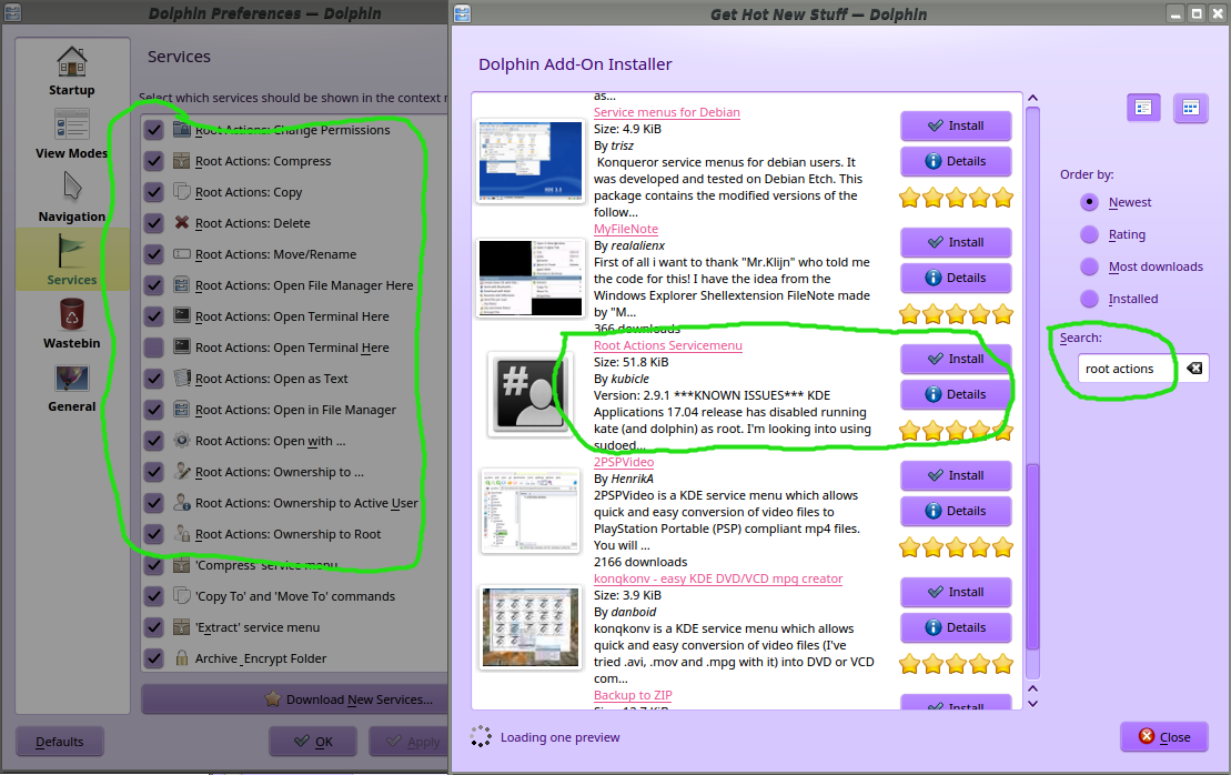

RE: Root action - leszek - 12th July 2017
If you activate in the service configuration of dolphin the move and copy options you will need to choose those entries from the root actions submenu in the contextmenu. It will then ask for a target directory or file. You must then enter or drag and drop the filename in there.

(12th July 2017, 13:00)leszek Wrote: If you activate in the service configuration of dolphin the move and copy options you will need to choose those entries from the root actions submenu in the contextmenu. It will then ask for a target directory or file. You must then enter or drag and drop the filename in there.
Here a screenshot of the service menu, all are activated, but none correspond to moving or copying files
