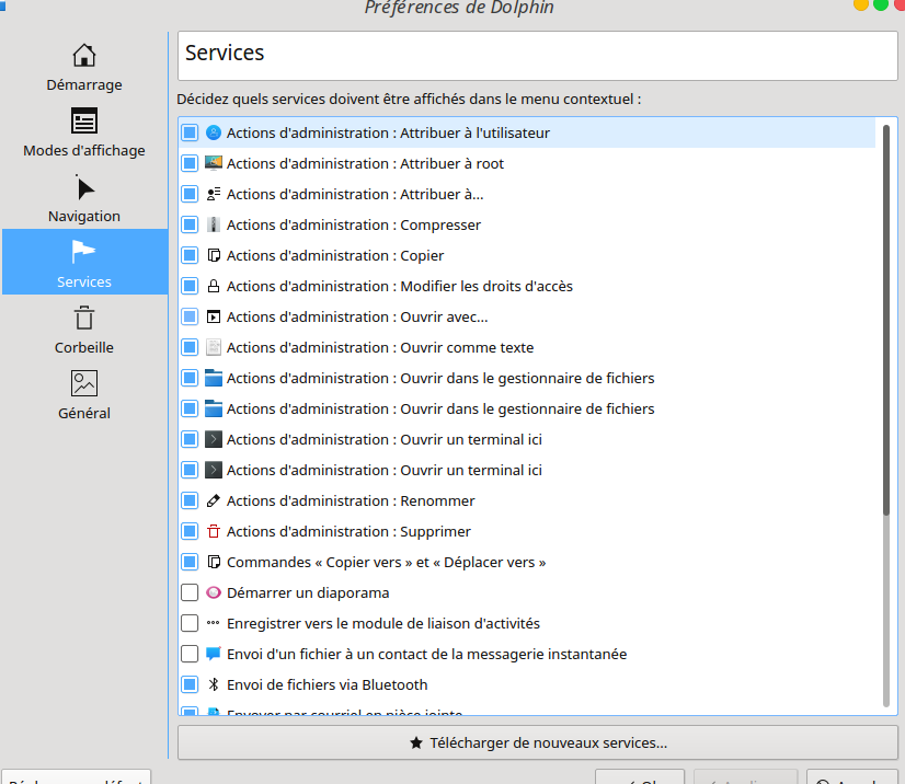

(12th July 2017, 11:19)leszek Wrote: Update: Noticed that we already patched root actions to work with pkexec. Though of course kate or dolphin can't open be open even with this. So if you need to copy/move/remove files as root activate the entries for this in the service menu to do so. It will then use pkexec to copy/move/remove files Smile
So Leszek, if I understand in the context menu (right clic) I can use the entry copy, move... to /directories. I have these entries activated but when I want to copy to any /directory the "copy here" is not active.
I miss something ?
12th July 2017, 13:00
If you activate in the service configuration of dolphin the move and copy options you will need to choose those entries from the root actions submenu in the contextmenu. It will then ask for a target directory or file. You must then enter or drag and drop the filename in there.

12th July 2017, 13:31
(12th July 2017, 13:00)leszek Wrote: If you activate in the service configuration of dolphin the move and copy options you will need to choose those entries from the root actions submenu in the contextmenu. It will then ask for a target directory or file. You must then enter or drag and drop the filename in there.
Here a screenshot of the service menu, all are activated, but none correspond to moving or copying files
