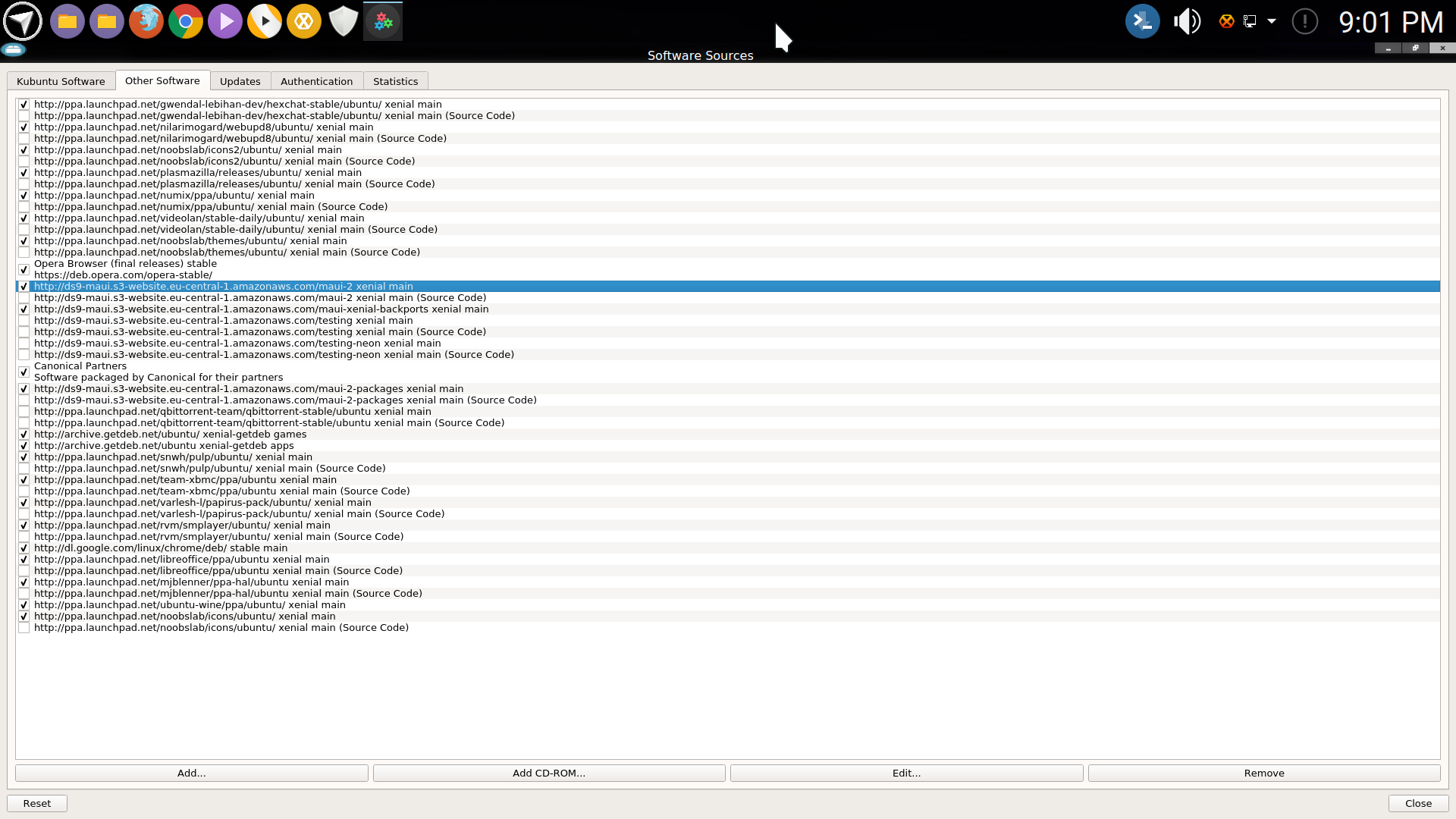

I noticed I had some duplicates in my software sources so i removed them. Does this look like its supposed to?
24th October 2016, 9:54
"maui-xenial-backports-neon" seems missing, you need this in addition if you enable "maui-xenial-backports" like in your current list.
24th October 2016, 9:57
First you have maui-xenial-backports checked which we have by default unchecked. (See blogpost on the homepage) and then I can't seem to see the maui-xenial-backports-neon source anywhere.

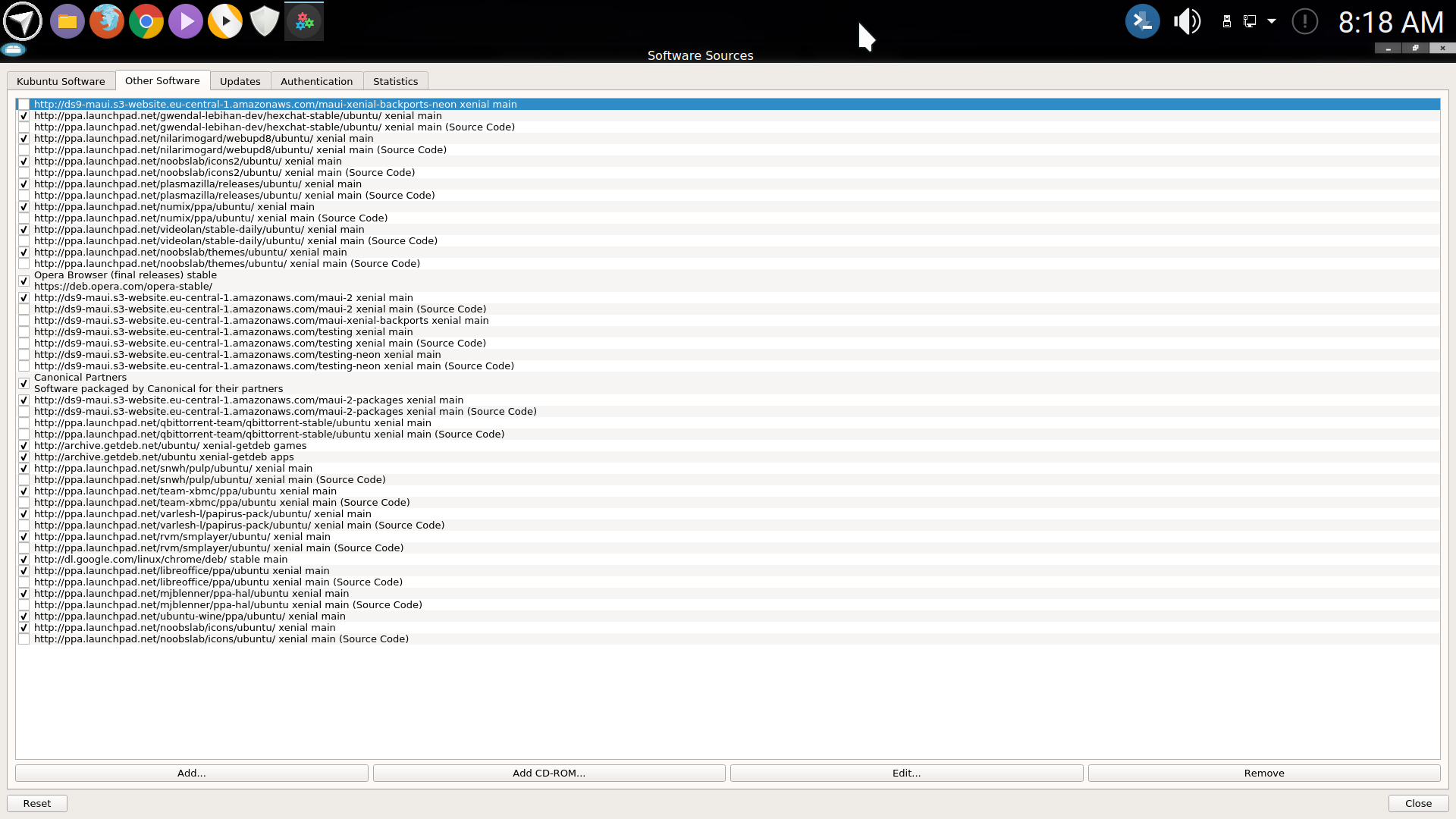

24th October 2016, 15:25
hmm, how about now?
24th October 2016, 15:27
Looks ok to me now.
