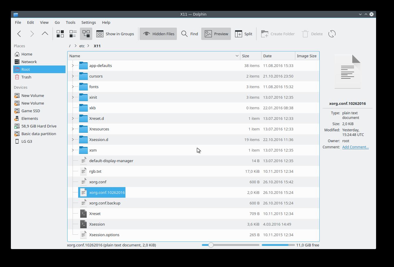

27th October 2016, 10:59
@rocky7x I have installed bumblebee following tutorial you provided, yesterday I managed to run Dead Island and System Shock 2 with primusrun but Half Life games was not launching, but today working games also stopped working. I did update my system yesterday without really checking individual updates so I uninstalled and reinstalled bumblebee again but no luck. Games won't launch with neither optirun nor primusrun. Glx gears work with either of them tough. Also I don't have the file "20-intel from /etc/X11/xorg.conf.d/" you mentioned. I attached screenshot of my x11 folder.

27th October 2016, 11:30 (This post was last modified: 27th October 2016, 11:32 by rocky7x. Edit Reason: added Half-Life instructions )
@sputnik_tr_02: Please paste the content of xorg.conf from your /etc/X11. The only difference I see is that I don't have xorg.conf at all. I use only defaults  Big Grin So maybe the xorg.conf from /etc/X11/ interferes with it somehow. I had similar behavior as you before (when I made it work but after reboot it stopped working), but I think it was all because of those bloody xorg.conf files. And Ubuntu 16.04 introduced the graphics-manager functionality which should automate the detection of graphics cards, but it does more harm than good. So please paste here the content of xorg.conf, so we see what you have in it and then maybe we conclude that you don't need it at all and then it'll all work  Wink

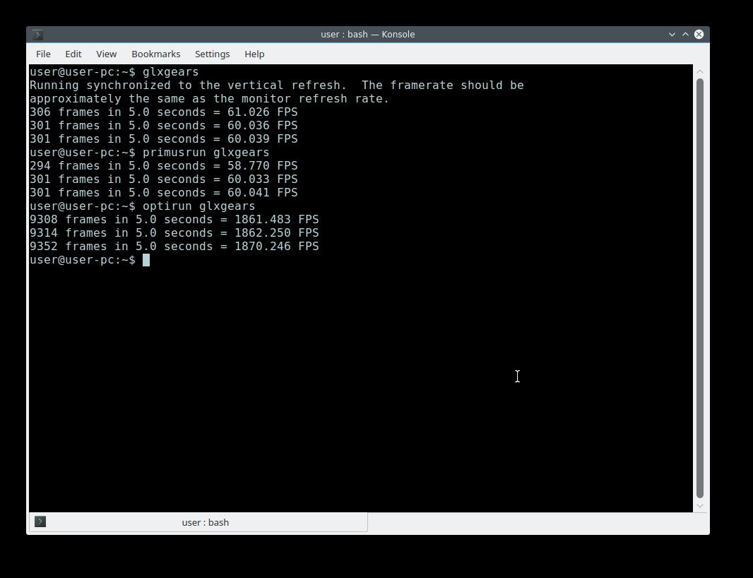

28th October 2016, 9:37
@rocky7x: The thing is that glxgears runs both with optirun and primusrun. But with primusrun it does not pass 60 FPS. I may try your suggestion, however fresh install could be a quicker solution for me  Smile
Here is my glxgears results for each command:
