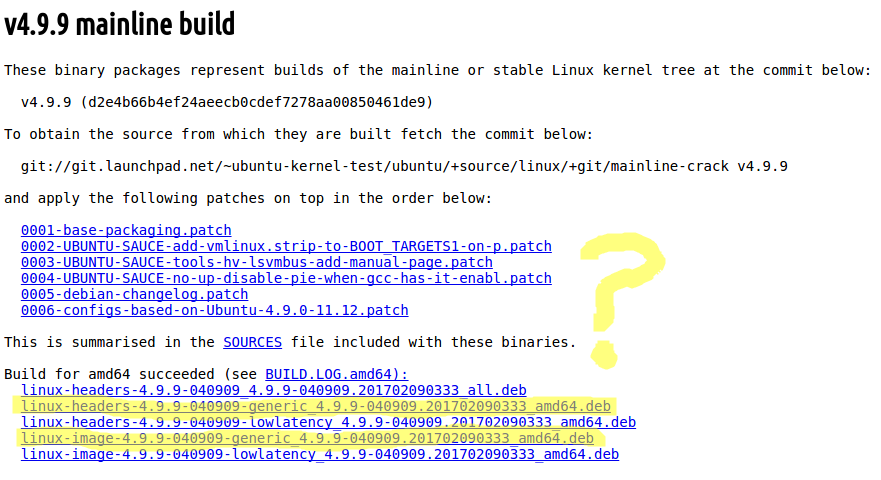

I assume you are referring to:
I read the Wiki, & basically became quite scared; i'm not confident of my ability to perform the necessary tasks correctly. I'm perfectly capable of following detailed instructions that i understand, but in this case there's a LOT of jargon that i just don't understand. Eg;

Quote:oh, is this it? = Ukuu Kernel Upgrade Utility
Never heard of it.
I would not suggest using it.
What you actually just need to do is download all the deb packages of your screenshot that don't include lowlatency in their name.
Then you can install all those 3 packages with the dpkg commandline tool.
Example:
sudo dpkg -i /path/to/package1.deb /path/to/package2.deb /path/to/package3.deb
It should then just install this kernel together with its header and automatically create a new grub entry for that new kernel which will be booted by default. I will also rebuild the virtualbox module (vboxdrv) automatically and make it available for this new kernel.
The older kernels will be made available in grub so if anything goes wrong you can just boot with an older kernel by choosing it in grub and remove the newer upstream vanilla kernel.
Its really not that complicated and with the option to boot with an older kernel you don't have to be to afraid trying it Smile

OK, your words give me more sense of reassurance than i felt earlier, thank you. Is this a fair action-plan summary then?:
1. As i am using the Nouveau graphics driver already, i do not need to take any action here.
2. I also don't need to do anything with my sound card.
3. As i am already using the latest Oracle VB version [5.1.14, per an earlier post of mine in this thread], i do not need to do anything here either.
4. Download linux-headers-4.9.9-040909_4.9.9-040909.201702090333_all.deb
5. Download linux-headers-4.9.9-040909-generic_4.9.9-040909.201702090333_amd64.deb
6. Download linux-image-4.9.9-040909-generic_4.9.9-040909.201702090333_amd64.deb
7. Run your command [substituting the actual correct names of course]
8. Reboot
9. Presumably if i didn't make an error, grub will show kernel 4.9.9 as the new default at top of boot list. Select it [or let it auto-select via timeout]
10. Hold my breath, cross my fingers, stand on one leg, & see what happens.
