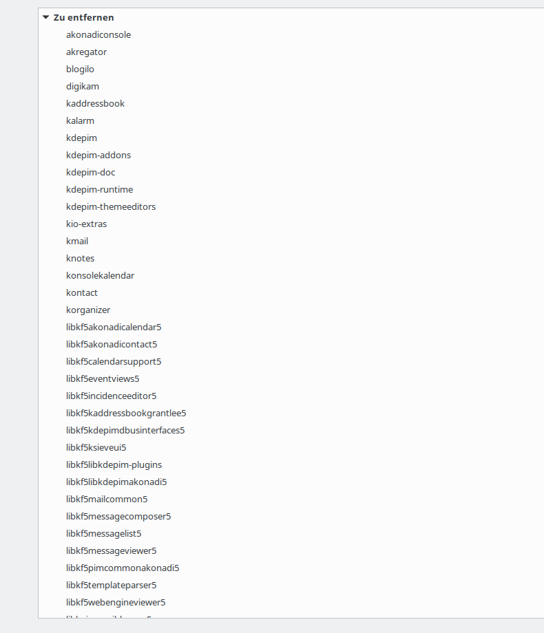

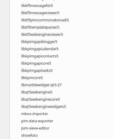

The current update to Plasma 5.11.3 will remove many of my installed packages. See screenshot attached.
Kindly look into this issue. I am especially worried about Kdepim and kmail.
Regards,
Nixus

Do you have any third party repos turned on. This looks all wrong from here.
Would be interesting to know why it wants to remove so many packages
Can you execute sudo apt-get upgrade -o Debug:: pkgProblemResolver=true in a terminal and post the output according to our forum rules (use code or quote tags)

(24th November 2017, 17:28)leszek Wrote: Do you have any third party repos turned on. This looks all wrong from here.
Indeed I have couple of them turned on. Executing the above gives the following output:
E: Option Debug::: Konfigurationswertspezifikation benötigt ein »=<Wert>«.
This is german an means: specification configuration value needs a <value>
24th November 2017, 18:59
Please remove the space between :: and pkgProblemResolver=true

25th November 2017, 12:24
Still looks strange to me and I don't find a reason why it isn't upgrading the libkf5 packages.
Though in this output I don't see that it wants to remove packages. So upgrading should be relatively safe.
Maybe after upgrading those packages you can upgrade also the rest of the packages that are hold back currently.
25th November 2017, 12:33
Maybe just asking a stupid question, but have you tried the upgrade via command line with the following:
sudo apt-get dist-upgrade
Nixus Offline
Joined: Nov 2017
Posts: 11
25th November 2017, 14:09
(25th November 2017, 12:24)leszek Wrote: Still looks strange to me and I don't find a reason why it isn't upgrading the libkf5 packages.
I upgraded but couldn't upgrade the rest of the packages which were held back in the second step. So I decided to let remove before mentioned packages hoping to be able to reinstall them later, but I still get error messages that some packages are broken or dependencies not fulfilled when I try to install kmail for instance.
Nixus Offline
Joined: Nov 2017
Posts: 11
25th November 2017, 15:07
Output for sudo apt install kmail and sudo apt-get dist-upgrade, unfortunately in German.
