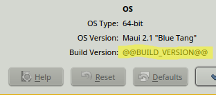

Hi. I've done this for a couple of my VMs, & it worked fine, but i have a query per the following pic... isn't that highlighted part supposed to have an actual date & time or similar?
#22
28th November 2016, 10:23
Yes it should have. Though this is set on build date of the ISO itself. So if you update the package it will replace the build date with a placeholder.
#23
28th November 2016, 10:54
Ah, i see, ok thanks. I think i might cheat here then, & edit the file...
