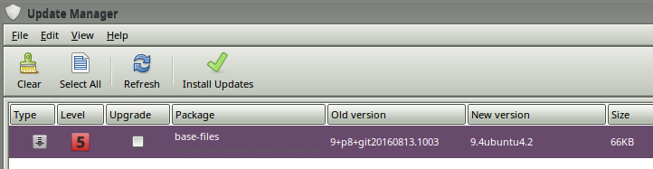

Generally speaking, can i pls get some advice on what my attitude to accepting or ignoring updates like these should be? For now i have left it pending.

Hi, thanks. Yeah, i am familiar with that rule of thumb, but... If an update [per picture] relates to "Base Files", that sounds to me simultaneously potentially catastrophic if it goes wrong, but otherwise logically important to accept... Base Files sounds pretty basic to my system, so QED, my system should be kept up to date with such basic files. All of which just keeps me going round in circles of indecision. Ha! My usual default attitude is to just take a deep breath & accept all such updates [whilst crossing my fingers, standing on one foot, & facing East], but i decided today i'd ask first.

Base-Files is something I don't advise to upgrade.
It is just a bunch of basic configuration files amongst the os-release and lsb-release files telling what distro you are running.
Usually with apt-get upgrade this should not be updated as the updated version comes from Neon and would overwirte those config so your system will be called Neon onwards which I don't think you want.
There is a nice little help in the update tool which tells you what those numbers mean for the updated packages.
Usually higher numbers mean higher risk of breaking your system.
12th October 2016, 9:51
Weell today the apt sources have been changed by the upgrade of the maui-apt-config and that is probably the reason why there is a new version of the package base-files. I've installed it and basically nothing happened. The only thing I'm not sure it the version of the system. Mine is currently this:

Maui has something else. Though it seem like mintUpdate ignores package priorities. Please install the base-files version of ds9 maui source.

OK, I've found via my Maui VM that it was not correct - it updated from official Ubuntu repository, which I guess was added by the new Maui apt conf. The only valid version of base-files for Maui is the oldest one in the Synaptic version list - this one: 9+p8+git20160813.1003 - when I downgraded to it, the /etc/lsb-release is OK again:
~$ cat /etc/lsb-release
DISTRIB_ID=Ubuntu
DISTRIB_RELEASE=1
DISTRIB_CODENAME=xenial
DISTRIB_DESCRIPTION="Maui"
So indeed, base-files should not be upgraded. Funny though that after I downgraded back to the Maui version, it doesn't want to upgrade it anymore ;-) As if it doesn't see the newer versions as it did before...

Anyway, I've found out that after the maui-apt-conf is upgraded and base-files pops up in the upgrade list, it is sufficient to refresh the list once more and it will disappear again - tried it in the VM and it worked like that. So it's not needed to upgrade and downgrade the base-files at all.
12th October 2016, 11:02 (This post was last modified: 12th October 2016, 11:03 by leszek. Edit Reason: typo correction )
Yeah seems to be the consequence of the repo change as the priorities list got changed for the new repo too but needs a refresh to really be reread.
