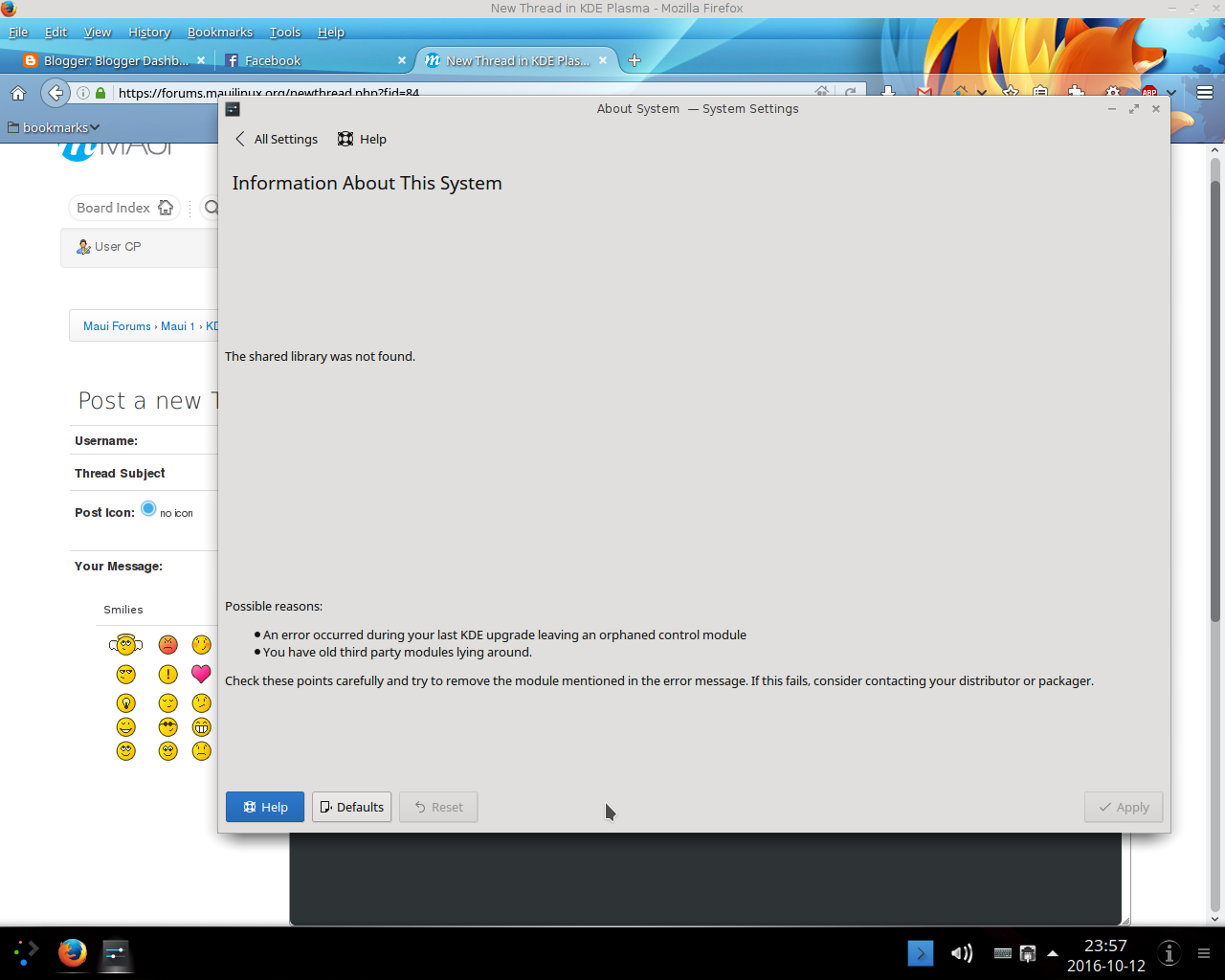

After upgrade The about system function was not found in the system setting menu.
How I can recover it?
What I need to reinstall?
I tried to reinstall systemsettings and not worked.
Thank you!

Try re-installing default-systemsettings-settings from the ds9-maui sources.

The reinstallation of default-systemsettings-settings dont fixed it. Sad

(13th October 2016, 7:20)chipola Wrote: The reinstallation of default-systemsettings-settings dont fixed it. Sad
I do apologize. I gave you the wrong package to fix this issue:
sudo apt-get install kcm-about-extended

14th October 2016, 0:41
Thank you, it Works!!
