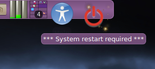

I have used CD for years, but only since my recent upgrades have i begun using one of its specific applets; "Logout". It is described thus; "This applet lets you manage the current session. You can either:   shut down, restart, hibernate, suspend, log out, lock the screen, switch to another user, or program an automatic shutdown. It will also tell you if your system needs to be restarted."
I have noticed that this CD applet frequently tells me that i have to reboot, & these notifications always seem to occur in tandem with Update Manager having installed various/any package updates. One of the things i loved about Linux when i changed to it from Windows in 2014, was the freedom from all the constant Windows reboots needed after its frequent patches, bugfixes, & updates... in Mint 17.x i simply never had to do any comparable reboots, unless of course i'd updated the kernel or a graphics driver & wanted to begin using it immediately.
In contrast, in both Mint 18 & Maui, this damn CD applet is frequently flagging to me that a restart is needed, & it's driving me nuts. Is this because of Ubuntu 16.04? Is it because of systemd? Or maybe, it is simply a bug in that CD applet & in fact i do not really need all the reboots at all...?

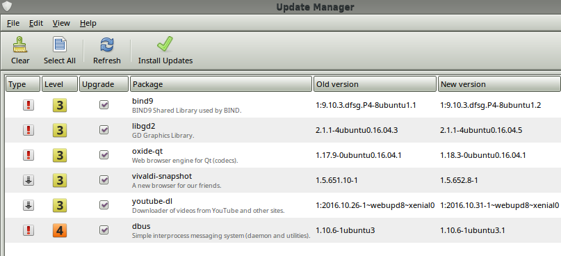

Here's this morning's innocuous updates, as a result of which, the applet is again unhappy:
I'd love to hear your advice pls.

Seems to be an issue in this applet I guess. As usually you are only advised to reboot after a kernel upgrade to use this new kernel.
2nd November 2016, 11:42
kdemeoz, I think the same like leszek, also I have Cairo Dock and appears the same, I think is a issue in CD.

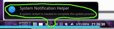

The very first Plasma5 VM i created, to begin my self-education of how Plasma5 differed to KDE4, was Kubuntu 16.04 (i installed this on 13/5/16] . It came as a shock to me that Kubuntu itself, via its native System Tray Notifications widget, consistently told me that a restart was needed, most of the time that system updates occurred. That was not CD telling me, it was Kubuntu itself.
To check my memory, after reading your replies, tonight i fired up my Kubuntu VM. As i'd not run it for a while, there were a large amount of updates needed. After it installed them, this happened:
I rebooted, then found another 7 updates were needed. Once again, after installation, its Notifier said to restart, so again i did. Tonight's experiment is entirely typical of my previous months of playing with Kubuntu 16.04. As i said in my initial post, this behaviour shocked me; Mint 17.x never did this.
Now its true that Maui in my Tower has not told me i need to restart, & [as best i can recall], neither has Mint 18 on my Lappy... instead in both cases it is CD telling me. However, how then can we explain the Kubuntu behaviour? So you see, my anxiety is that Kubuntu is obviously based on Ubuntu 16.04, as are both Maui & Mint 18. Ie, how can i tell for sure that it is only a CD applet bug, rather than the CD applet is faithfully responding to an underlying message from the OS... the same message that is directly available in Kubuntu?

Yes, but Kubuntu's Discover has been extremely buggy for me over the past month, continually stalling when part way through downloads & installing updates, even after several hours. This happened again last night, so i abandoned it & instead simply did it via apt-get in Konsole. After doing that, the same Kubuntu Notification per my previous picture, occurred... hence my ongoing point here.

It is the kubuntu-notification-helper that is causeing that issue on Kubuntu.
Maui doesn't use Kubuntu as it's base so no kubuntu-notification-helper, we use Mint update for our notifications.
