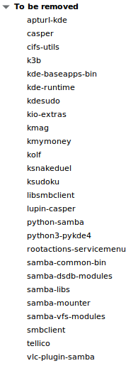

Thanks. Well, based on your advice, + my earlier info [that i do not use Samba & will never need to], i have now removed Samba via Synaptic [which also removed Winbind]. It was, btw, the same version that you indicated.
I was surprised to see however that there's several other Samba-like packages that Synaptic did not remove at the same time, & afterwards i found that even
sudo apt autoremove
did not remove them:
Presumably none of these things should be needed anymore on my Tower -- is that true? If so, then after your confirmation i shall remove each of these as well.

Sorry, i don't really understand. I've already explained that i do not use/need/want Samba, so [even though i do not know what a "samba client" is], presumably having removed Samba itself, none of the other stuff in my pic should be necessary? Or are you meaning that despite me not needing Samba, i should not remove these packages otherwise i might break my Maui?
28th May 2017, 16:00
Samba client is a needed for accessing smb:// shares. If you don't need or want this you can just remove that aswell.
28th May 2017, 16:29
In the pic i uploaded there are 10 packages related to Samba. What i am asking is simply this... is it safe (ie, i do not want to break Maui] for me to remove all 10 [given that i have already removed Samba version 2:4.3.11+dfsg-0ubuntu0.16.04.7]?
28th May 2017, 16:39
It should be save. Though when removing take a look that it does not want to remove anything that you still want or need.
29th May 2017, 2:53
Thanks. I removed most but not all of those samba-affiliated packages. The ones i had to leave, & why, are as follows (i must say, i find it pretty weird that removing an incidental ancillary pgm like samba, or in this case some of its related packages, would actually force removal of entirely unrelated major pgms like for instance KMyMoney, kdesudo, k3b, kde-runtime etc!!]:
