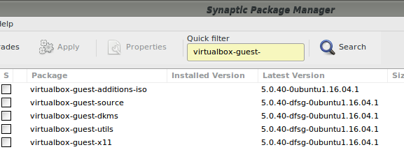

...unfortunately this does not solve my Tower's 17.06's 1 minute of black screen after the Maui login screen until my desktop appears. I checked, but
virtualbox-guest-x11
is not installed.
My 17.06 btw was an upgrade from 17.03 via Update Manager... it was not a fresh installation.
13th July 2017, 10:15
Have you checked that all virtualbox-guest-* packages are not installed?
13th July 2017, 14:54
(13th July 2017, 10:15)leszek Wrote: Have you checked that all virtualbox-guest-* packages are not installed?
