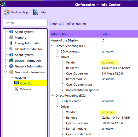

I'm a bit confused/worried about the "FAILED" in the Graphics section. What is your interpretation of what gpu & driver is active pls?:
Z97-HD3:/$ inxi -Fxz
System:    Host: Z97-HD3 Kernel: 4.4.0-63-generic x86_64 (64 bit gcc: 5.4.0)
          Desktop: KDE Plasma 5.8.4 (Qt 5.7.0) Distro: Ubuntu 2.1 xenial
Machine:   Mobo: Gigabyte model: Z97-HD3 v: x.x Bios: American Megatrends v: F7 date: 12/08/2014
CPU:       Quad core Intel Core i7-4790 (-HT-MCP-) cache: 8192 KB
          flags: (lm nx sse sse2 sse3 sse4_1 sse4_2 ssse3 vmx) bmips: 28801
          clock speeds: max: 4000 MHz 1: 3891 MHz 2: 3963 MHz 3: 3823 MHz 4: 3866 MHz 5: 3956 MHz 6: 3931 MHz
          7: 3820 MHz 8: 3976 MHz
Graphics:  Card-1: Intel Xeon E3-1200 v3/4th Gen Core Processor Integrated Graphics Controller bus-ID: 00:02.0
          Card-2: NVIDIA GF119 [GeForce GT 610] bus-ID: 01:00.0
          Display Server: X.Org 1.18.4 drivers: nouveau (unloaded: fbdev,vesa) FAILED: intel
          Resolution: 1920x1080@60.00hz
          GLX Renderer: Gallium 0.4 on NVD9 GLX Version: 3.0 Mesa 12.0.6 Direct Rendering: Yes

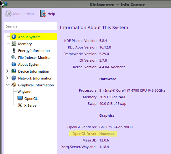

This implies Nouveau driver [good, that's what i want], but what actual gpu?
Ditto...?

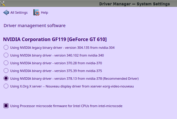

This indicates successful deployment & activation of rocky's suggested intel-microcode? [annoying/confusing that Driver Manager wrongly(?) implies i'm using Nvidia rather than Nouveau driver].

Seems you still use nouveau driver. In order to prevent this you have to blacklist it as described in article http://askubuntu.com/questions/481414/in...ad-nouveau
Seems you haven't installed the Nvidia driver correctly, because it should do the blacklisting itself. So either try to reinstall it or do the blacklisting yourself.
