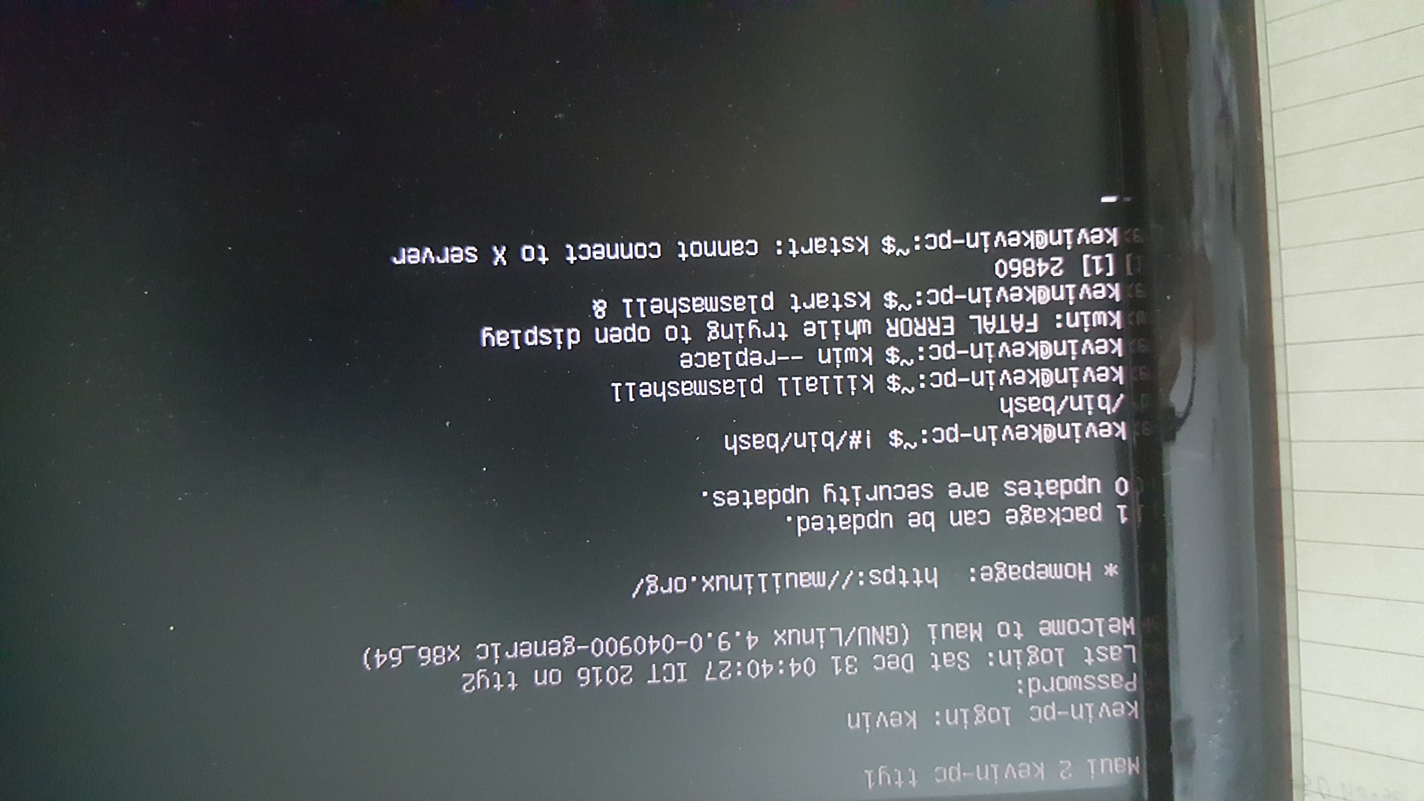

My plasma freeze again. I tried the shortcut but did not work, so I type in the command in tty1.

I found the pattern of the error. When I start the steam app and use multiple desktops grid display when the steam is connecting to my user account, it freeze. After sometime without doing anything I can go back to the desktop with ctrl+alt+7, but the wallpaper, panel, window bar, right click option dissapear.

I can go back to normal desktop using the shortcut, so the shortcut only works when the desktop partially work. It seems that I am not allow to use desktop grid while steam is connecting to my account.
