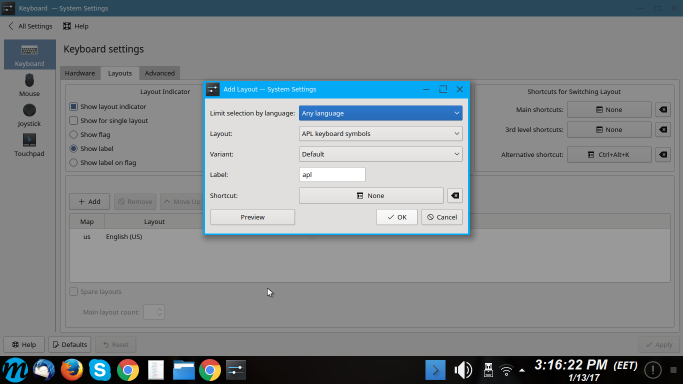

Hello! I want only keyboard in Greek, but there is not Greek keyboard! see in attachment...

Keyboard layouts > press add
Don't go to "Limit language by selection"
Go to "layout" and select Greek
If not there you will have to install Greek language
