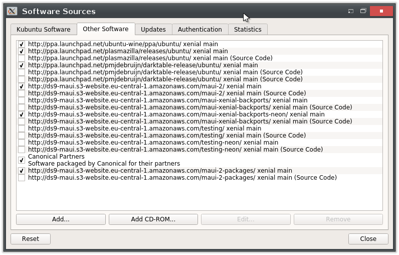

In 'About System', my laptop shows Maui 2 "Blue Tang", Build Version 20161024.1510, can I upgrade to 17.03 as instructed at
https://mauilinux.org/upgrading-maui-2-x-maui-17-03/
I am asking this because my source list does not contain any of 'maui-2.1' repos, it has only 'Maui-2' repos as shown in attached screen shot.
On  10/11/2016 I installed Maui2 from iso released on 28/10/2016 and updating regularly every week or when ever they are available.
'About System' shows
KDE Apps Version:16.12.0
Frameworks Version:5.29.0
Qt Version:5.7.0
Kernel Version:4.4.0-62-generic
Isn't my system 2.1? If no,should I first upgrade to 2.1 and then attempt for 17.03?
Please advise.

You can just activate the backports and it should upgrade. There is no way to actually upgrade to 2.1 as it was basically just a refreshed ISO release only containing a bugfixed installer Smile
The rest of the system should be identical to 2.1 if you kept it updated.
