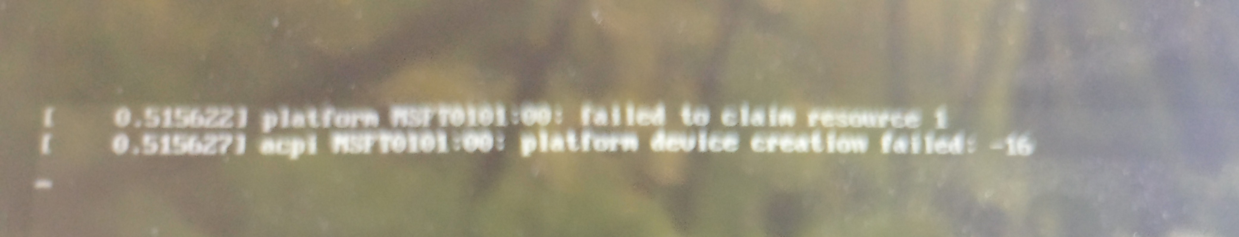

    Ok, I've noticed several errors during startup. Not sure if it connects to not having wifi. I added some photo's of the startup and quiting proces. Hop you can use it for adressing my wifi problem, but also for getting Maui better next version.
Btw: Network-Manager doesn't show anything about the wifi. And this laptop doesn't have a possibility for a network cable...
MarkoF Offline
Joined: Oct 2017
Posts: 9
18th October 2017, 18:42
And another picture of the next messsage.
