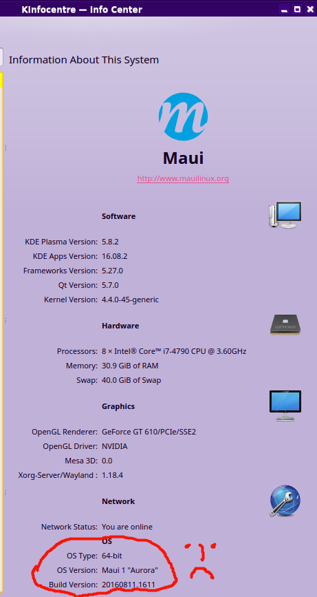

Thank you both. Maybe i'm just being too frivolous; if the important code in my installation is now already same as Maui 2 then possibly that's the only thing that really matters... but it'd be kinda nice if it actually told me it's Maui 2:
28th October 2016, 15:27
If you install the base-files package 99 from our repo it should tell you Maui 2 then Smile
28th October 2016, 15:47
Imo I'd even rather prefer if it didnt tell you "Maui 2" if you upgraded, so we still would know if its an original Maui 1 or 2 in the beginning IF some problems occur.

(28th October 2016, 15:27)leszek Wrote: If you install the base-files package 99 from our repo it should tell you Maui 2 then Smile
And how to do that ? Confused
28th October 2016, 15:58
It should be offered as an update in the update manager that you need to tick.
smoreau Offline
Joined: May 2013
Posts: 294
28th October 2016, 16:05
(28th October 2016, 15:58)leszek Wrote: It should be offered as an update in the update manager that you need to tick.
Not seen, after sudo apt-get update, no update package available.
28th October 2016, 16:06
Then maybe you have it installed already? Check with apt-cache policy
