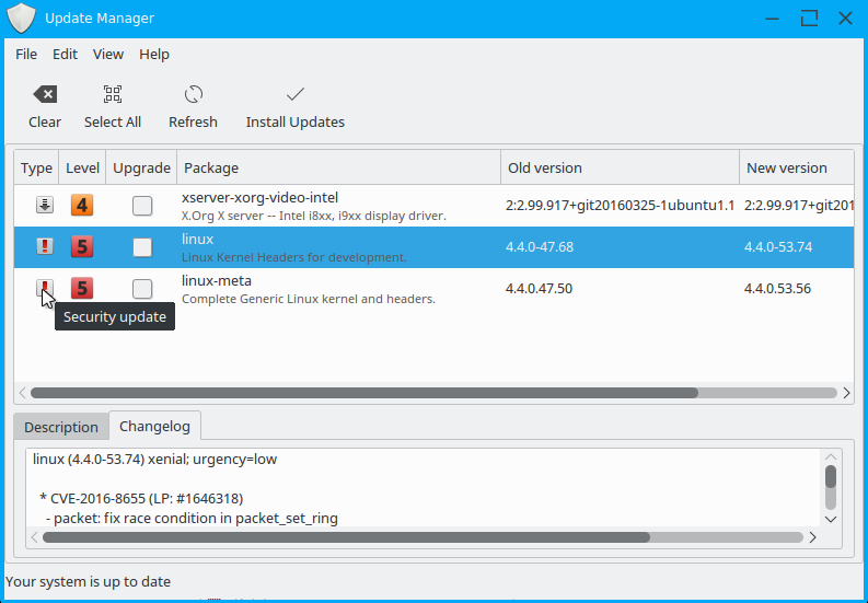

When I was running Netrunner rolling it had a neat kernel tool and I was always able to tell what I was running or should be running and what was LTS.   (I have no reason to run anything other than LTS!)
I'm currently running
Quote:$ uname -r
4.4.0-47-generic
...and update manager (see screenshot attached) is listing an kernel update: it says "security update)" but it is a level five update and in the preferences, a level description for 5 is: "Dangerous update.  Known to affect stability..." etc etc.
Should I install? Please educate me.
Thanks!
10th December 2016, 11:59
It is an LTS kerne update. You can update it. By default the kernel will be installed alongside so you can boot the old one if anything goes wrong.
Level 5 only indicates that this is an update that might break your experience.
