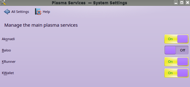

They don't appear in the menu on purpose.
If you want to use them you need to activate Akonadi first from the systemsettings -> plasma services.
After that they should work with Akonadi.
If you want them to appear them in the menu add them to it with the menu editor (accessible via right click on the menu button).
The editor also allows you to remove our customized menu and use the system one.

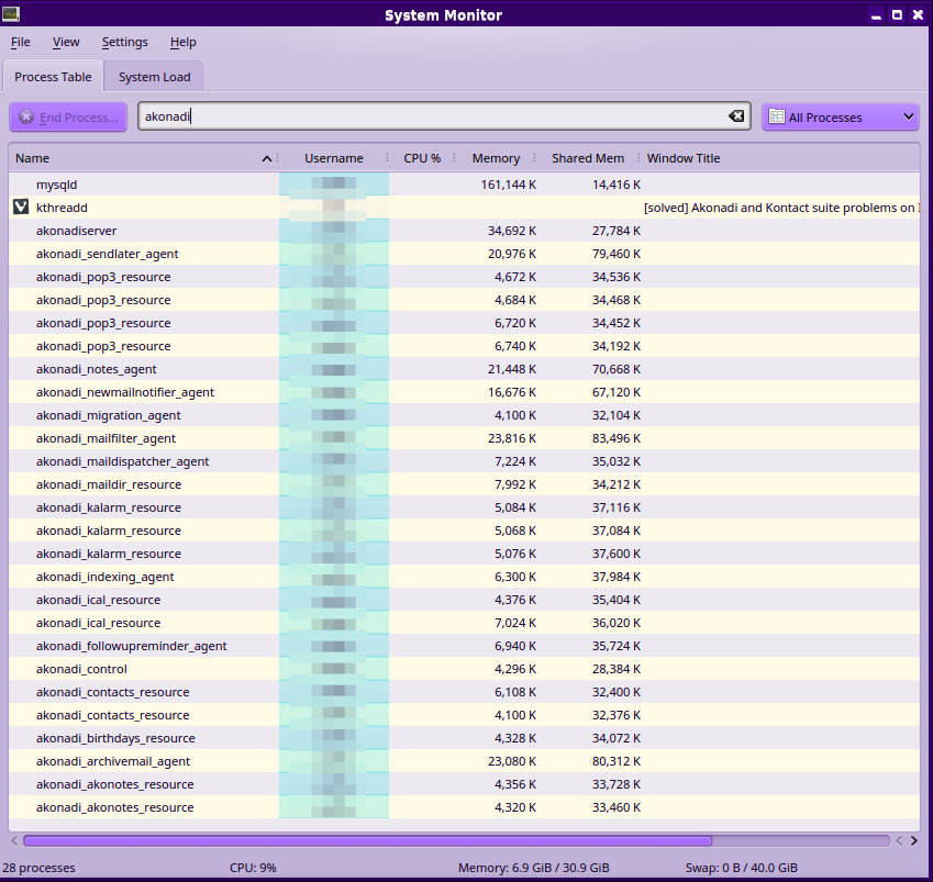

(29th October 2016, 16:13)leszek Wrote: If you want to use them you need to activate Akonadi first from the systemsettings -> plasma services.
Am i correct to infer from this that a standard installation of Maui would/should NOT have Akonadi enabled in Plasma Services?
I am very happy to not use the KMail/Kontact suite in Maui [& i have not tried to]. I tested it extensively back in Mint 17.x KDE4 a couple of years ago, & it caused me massive hassles with bugs & instability, + a very unfriendly unhelpful KDE Community when i asked about its faults.
My post here now is because in my Tower's Maui, Akonadi IS enabled & running... i did not do this manually... & i had long wondered why this was happening. Should i / can i now safely disable it in Settings? I know that i could always just try it myself without asking, but i do not want to cause some damage if i have misunderstood & maybe it should really be running.
5th November 2016, 10:22
If you use the calendar widget with holidays or other calendars akonadi might be necessary to grab the calendar stuff.
5th November 2016, 11:01
Oh. If i decide not to bother with that [calendar widget holidays], is it then safe for me to disable Akonadi in Settings [ie, i won't actually crash Plasms5 / Maui]?
5th November 2016, 11:15 (This post was last modified: 5th November 2016, 11:16 by leszek.)
Yes it should be save.
Holidays in calendar should be independent from akonadi Btw. Only other vcal or ical resources need it.
