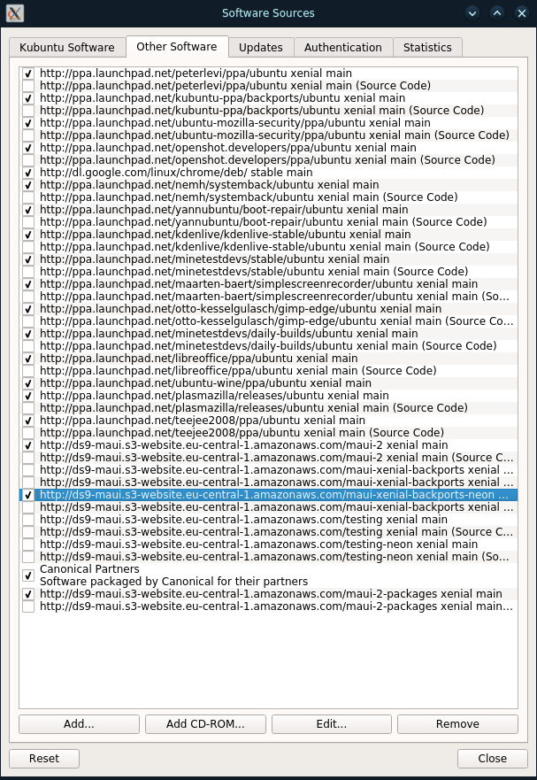

Mine look likes this
31st December 2016, 1:29
Ah, well now i suspect the mystery is probably resolved. My Maui ones are the same as yours, which is unsurprising given that leszek https://forums.mauilinux.org/showthread....4#pid41094 already said to me that "Everything is alright with your sources.list no need to edit it". leszek also advised us https://forums.mauilinux.org/showthread....5#pid41105 that "we are still testing 5.8.4 and 5.8.5 before we release it to our users via backports repo".
I now believe the reason you have 5.8.4 is probably your kubuntu backports PPA. From following the Mint KDE forum thread on this i think that's the way that Mint KDE recently jumped from 5.6.5 to 5.8.4. Personally however i continue to dislike their stubborn insistence of staying tied to Kubuntu rather than Neon, & that was the reason that i chose to leave Mint for Maui earlier this year.
I'm unwilling to use the kubuntu PPA, so i will wait for our Maui Devs to release 5.8.5... hopefully soon after new year would be a nice gift  :-)
