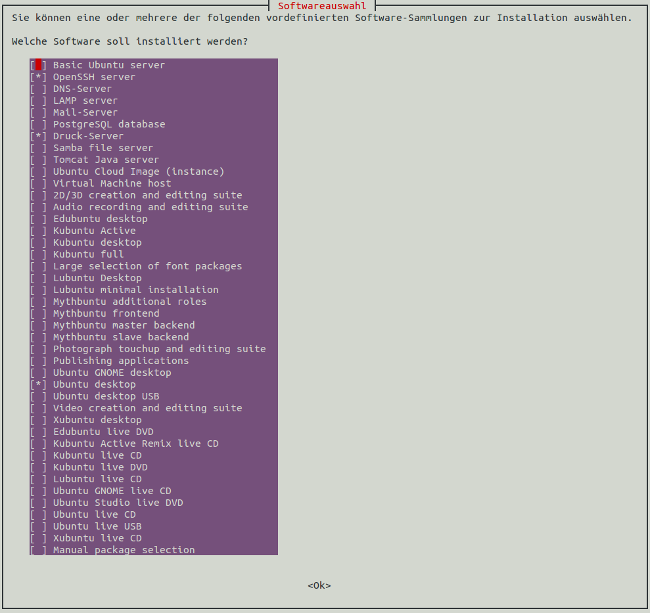

A few minutes ago i have installed "tasksel" on my testing system because i wanted to install "LAMP" with "tasksel".
# sudo apt-get install tasksel
Then i startet "tasksel" at the terminal.
# sudo tasksel
Now tasksel started with it's small text based gui.
I deselected the previous marked and selected "LAMP" and pressed OK.
Then the the message comes, "install package".
But after a few minutes i was wondering what "tasksel" doing, it deinstalling the system.
I stopped this process by closing the terminal, then i did a reboot.
Now it seems my testing "Maui" is destroyed 'cause it wouldn't boot into system altough the entry of my testing "Maui" is shown in "GRUB2"
What have i done ?
Did i make a mistake using the small text based gui instead of using the command in terminal.
# sudo tasksel install lamp-server
Now my question is, what was happend using "taskel" and could i repair the testing system or should i make a backup of my doc's pic´s etc., cleaning up the partition with the testing system and make a new install of "Maui" ?

I guess the problem is caused by you deselecting stuff in tasksel.
The easiest solution is to reinstall. Just by checking stuff in tasksel again won't bring back the maui specific packages.
