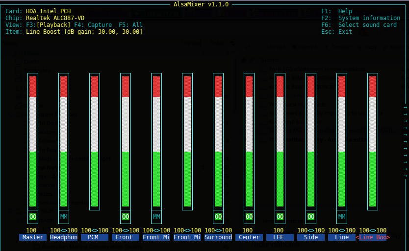

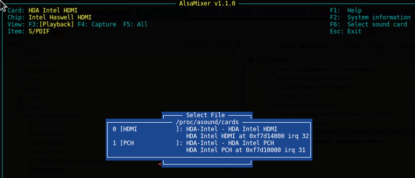

Can you run alsamixer in a terminal switch with f6 to the right soundcard and take a look at Master, Speaker, PCM mixer values there. Turn them up (hopefully they are able to turn up) to raise the volume.
8th March 2017, 5:08

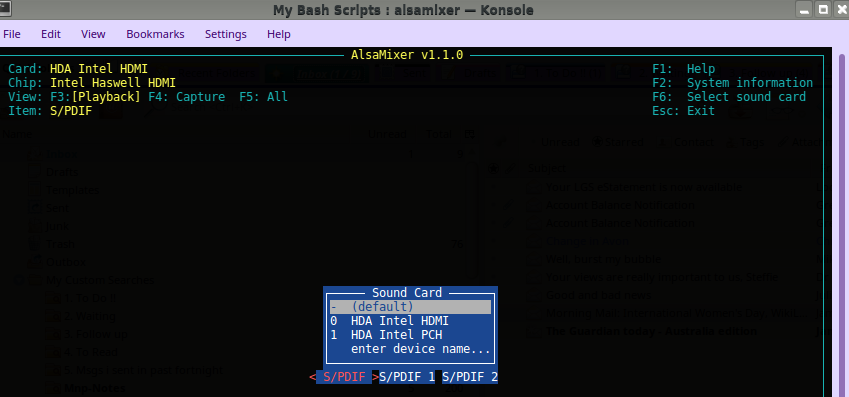

Hi & thanks. I had previously looked at that, but had not understood how to "control" it. Following your suggestion i have now spent a lot of time fiddling with it, all the while streaming music with Clementine, so i would be able to instantly assess if anything good [or bad] happened. Nothing i tried at all helped to raise the sound volume to "acceptable", though i was able to find some settings that reduced it [which obviously is unhelpful, other than it proved these settings were active].
Before i paste several pics, back to my original question; "is such muted volume simply normal for integrated sound-cards, or not?" --> can i infer from your reply that in fact an integrated sound-card actually should be able to produce acceptable output volume?
  • If that's the correct answer, then it would follow that my current problem is bad speakers, so i need to buy new ones...?
  • Of course, if the opposite answer is true, that in fact integrated sound-cards are never as "loud" as separate cards, then it would seem unavoidable that i shall need to reinstall my Nvidia GT610.

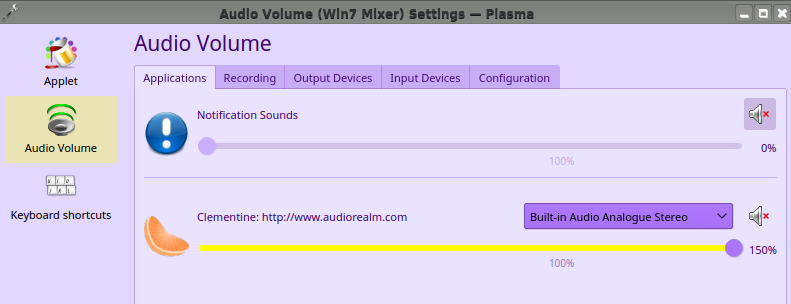

Here, most of the bars were already maximised, but i manually increased the others also to maximum:

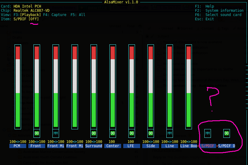

I don't understand what these 2 RHS bars do, but i couldn't find a way to change them:

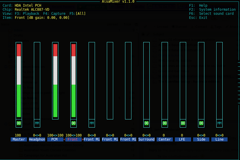

From experimentation i found that only these 3 bars made any difference to the volume, but as you can see they're already maximised (ie, the only difference i could make here was to lower them; unhelpful), but the speaker volume remains far too soft:

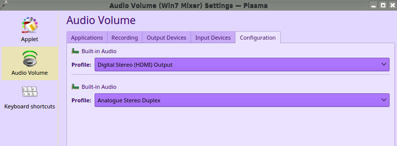

8th March 2017, 5:19

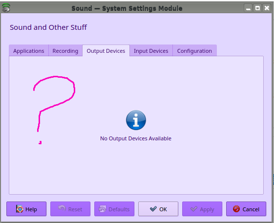

This seems to be a problem...?
Other graphical settings FYI:

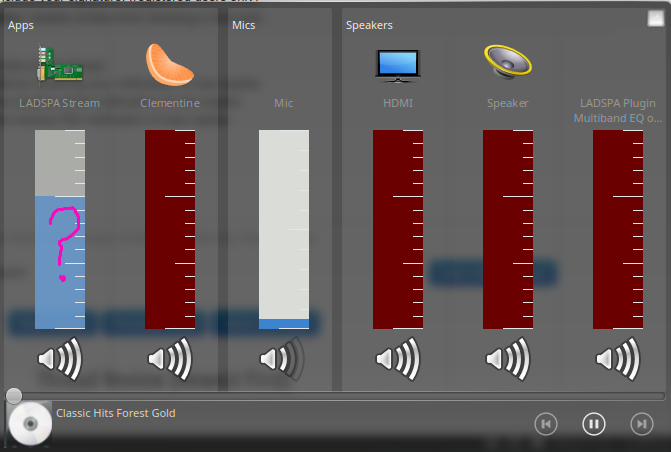

I don't understand the LHS bar, & could not change it. The 4 red bars are already maximised, with the "Volume Boost [150% Volume]" set. Clementine is also maximised in the pgm GUI itself. None of this helps; the speaker volume remains far too soft:

So everything is at max. That means it should work fine. Are you sure that the speakers are OK? Can you control volume on those speakers?
Do you have a mixer or some other hardware to test the output from the soundcard of the pc in any way to see if it is loud enough?

The good thing with the new volume applet is you can right-click on its tray icon and should be able to bring up also pulseaudio volume.
Maybe that brings more insight?
8th March 2017, 11:24
(8th March 2017, 11:09)starbuck Wrote: The good thing with the new volume applet is you can right-click on its tray icon and should be able to bring up also pulseaudio volume.
Thanks, & i do agree that the new applet is great. However i had already discovered this extra functionality, indeed several of the pics i uploaded came from this method, so i seem to be at the end of my configuration adjustment options [as far as i have so far discovered, anyway].
