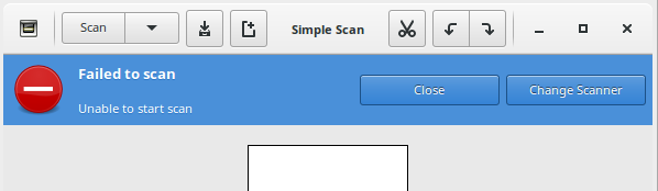

I am beginning to suspect this is possibly a problem with the Brother drivers, not Maui [given the identical problem plagued me before Maui in Mint 17/17.1/17.2/17.3 KDE4], but i thought i'd ask here before i just give up.
Per the subject line, today after performing the Brother setup [see below] in my Tower's Maui 17.03, my MFC-7220 prints just fine, but the Scanner fails [also see below].
Here's what i did [sort of a compendium of advice on the Brother site, + a couple of other sites]:
Installed the necessary 32bit libraries:
kdemeoz@GA-Z97-HD3:~/Downloads/linux-brprinter-installer-2.1.1-1$ sudo apt install ia32-libs

Following this, even without needing a reboot, the Test Print & a "real" print of an actual document of mine, worked just fine. So then i turned my attention to the Scanner...
1. As advised in Brother's instructions, add the following lines to “/lib/udev/rules.d/40-libsane-rules”:
    a)Put them at the end of the list of vendors, just before the line that says "# The following rule will disable":
        i. # Brother scanners
       ii. ATTRS{idVendor}=="04f9", ENV{libsane_matched}="yes"
2. Copy /usr/lib64/sane to /usr/lib/  [ie, final directory in destination = /usr/lib/sane]
3. Add myself to the scanner user group.
4. Install Simple Scan, eg, with Synaptic.
5. Reboot (to restart daemons)
6. Run Simple Scan from the Graphics menu to test the scanner. --> Oh %#@!~^ it. It does not work, just like in Mint before Maui.
Any ideas, pls?

is correct ?
I mean if the scanner is attached via usb lsusb should show you the ID and the first one XXXX:YYYY (so the X's) should be the vendor id.
Maybe it is different for your device.
21st March 2017, 2:04
(20th March 2017, 12:29)rocky7x Wrote: Hi,
There is an excellent article about Brother scanners for Ubuntu, but it is in German. So either use Google translate or maybe some of the German colleagues here on forums could translate the essence of it for you.
https://wiki.ubuntuusers.de/Scanner/Brother/
Thanks rocky, i shall have a look at this, & cross my fingers that it unveils some hitherto missing gem.
21st March 2017, 2:09
(20th March 2017, 14:01)leszek Wrote: Have you checked if that vendor id
Quote:ATTRS{idVendor}=="04f9", ENV{libsane_matched}="yes"
is correct ?
Thanks leszek, that's a good idea, it never occurred to me that maybe the collective guides i had followed might have been wrong for my specific machine. Sadly however, no...
GA-Z97-HD3:~$ lsusb
Bus 003 Device 009: ID 04f9:0185 Brother Industries, Ltd MFC-7220 Printer
Sad
4th April 2017, 17:12
Finally had some time to come back to this. The article is quite good, & told me some stuff i'd not read in other references. I tried those changes, but scanning still fails with the error msg. Bummer.
Totally exasperating. Now giving up on this, with conclusion that Linux & Scanners do not like each other [given same failures with Mint 17/17.1/17.2/17.3 & Maui 2.1/17.03]. Marking original post as "Unsolvable".  Sad
