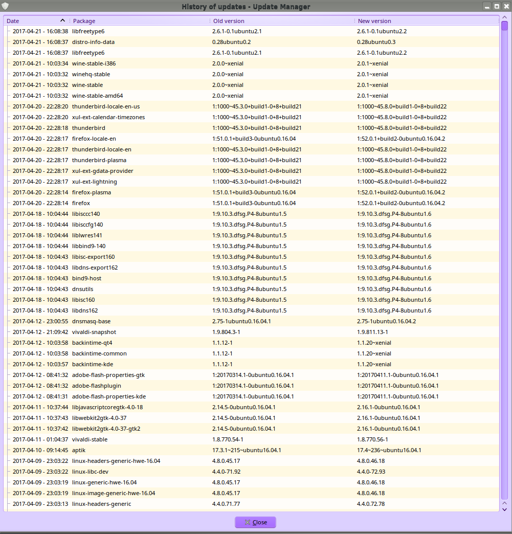

I checked Update Manager's recent history, but cannot see any recent changes that should be relevant here:
Sigh.
