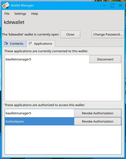

ksshaskpass does get authorization though. So it seems to be interacting. It's just not saving passwords when hitting the "Remember Password" tickbox.

I've tried every combination I can think of. Manually creating a wallet, allow it to auto create one. Rebooting the machine after creating a new one.
