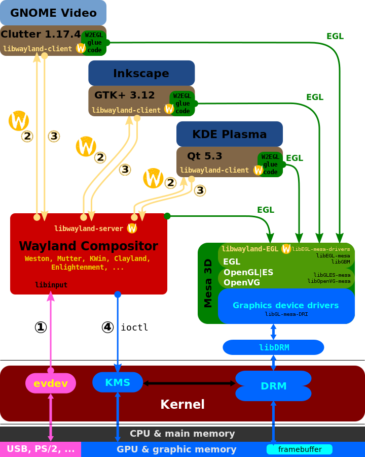

I think they have maui mixed up with... http://hawaiios.org/
and no we not wayland.
Bit of info....and I don't pretend be proficient on this subject!
① The evdev module of the Linux kernel gets an event and sends it to the Wayland compositor.
② The Wayland compositor looks through its scenegraph to determine which window should receive the event. The scenegraph corresponds to what's on screen and the Wayland compositor understands the transformations that it may have applied to the elements in the scenegraph. Thus, the Wayland compositor can pick the right window and transform the screen coordinates to window local coordinates, by applying the inverse transformations. The types of transformation that can be applied to a window is only restricted to what the compositor can do, as long as it can compute the inverse transformation for the input events.
③ As in the X case, when the client receives the event, it updates the UI in response. But in the Wayland case, the rendering happens by the client via EGL, and the client just sends a request to the compositor to indicate the region that was updated.
④ The Wayland compositor collects damage requests from its clients and then re-composites the screen. The compositor can then directly issue an ioctl to schedule a pageflip with KMS.
https://wayland.freedesktop.org/architecture.html

(11th January 2017, 15:18)Pliny.D.Elder Wrote: I think they have maui mixed up with... http://hawaiios.org/
