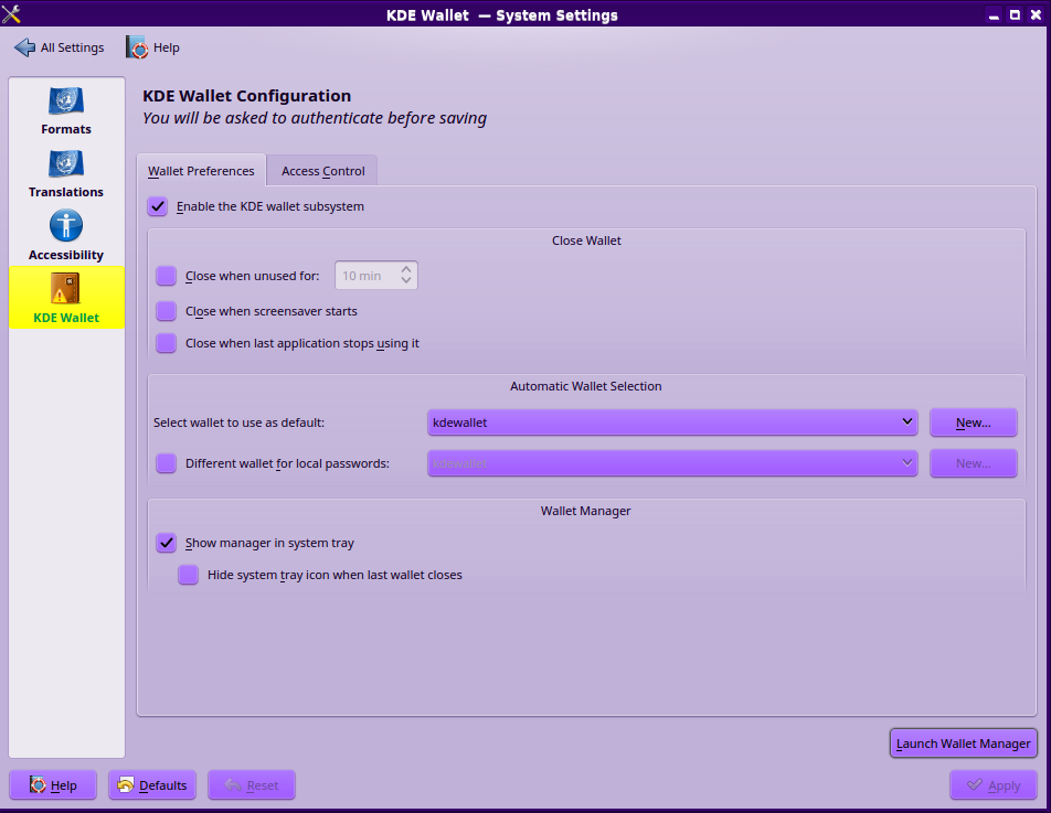

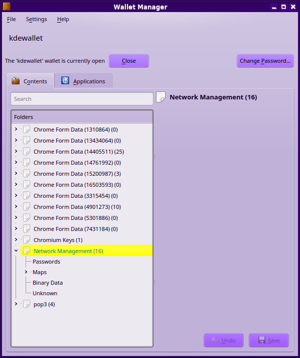

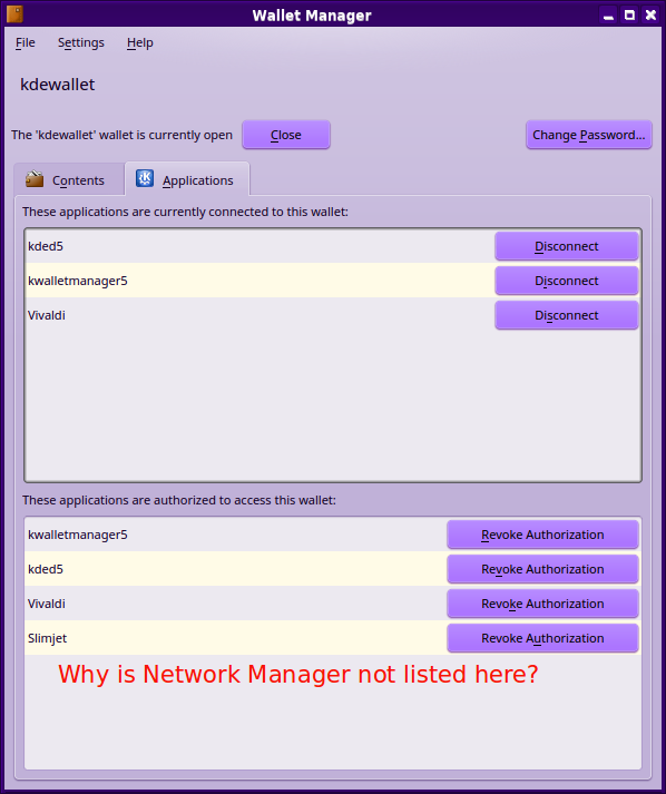

3. I looked again at Plasma's KDE Wallet and Wallet Manager. The specific reason, throughout my thread here, for me alleging that kwallet is "broken" after logging out/in [but is instead perfectly fine after a cold start or a hot reboot], is that every time i start my Tower, or Resume it, or Reboot it, or Logout/In, the FIRST THING i then do is to activate my VPN, by clicking the Network Manager applet in the System Tray. Then, & only following the logout/in rather than any other start mode, it prompts me for my kwallet password [which should not occur, as it should have got this from my login], & then it rejects my inputted password.
Hence my next question: should i be surprised that Network Manager is not listed as one of the applications authorised to connect to my wallet? How can that be right? If it's not authorised, WHY do i even get prompted when i try to connect to the VPN after logout/in, & alternatively HOW could i have no problem activating my VPN via Network Manager from a cold-start, reboot, or resume?
Do you think it might be worthwhile me trying either of these:   (a) delete the current wallet & create a new one? (b) create a second wallet alongside the current one?
