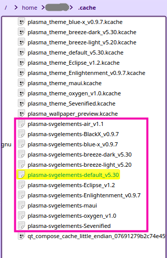

12th July 2017, 17:04 (This post was last modified: 12th July 2017, 17:06 by kdemeoz. Edit Reason: pic added )
(12th July 2017, 11:11)leszek Wrote: What you can try are these things here. Try them one by one not all at once please.
1. Remove the plasma cache (just in case): ~/.cache/plasma-svgelements-default* files need removal and relogin
2. Disable VSync in Compositor setting
3. Try Xrender instead of OpenGL
4. Force usage of modesetting driver. Create a file with root rights in /usr/share/X11/xorg.conf.d/20-intel.conf with the following contents
Quote:Section "Device"
   Identifier "Intel"
   Driver "modesetting"
   Option "AccelMethod" "glamor"
   Option "Backlight" "intel_backlight"
EndSection
Then try rebooting. If you only get a black screen please login via tty (Ctrl+Alt+F1) and save the Xorg.0.log from /var/log and remove the created file above.
I hope one of those steps will make things work again for you with Maui.
Many thanks for this.
Re #1, your instruction implies multiple files, but i seem only to have one. In my pic, is the selected file the only one to delete?
Re #2, note that in KaOS & openSUSE Tumbleweed that setting is still Enabled, yet they [as i said before] do not get any of these KWin crashes. However i will test this, tomorrow, if #1 does not help.
#24
12th July 2017, 17:07
As for #1 you only have multiple files if you played around with different plasma themes.
#25
