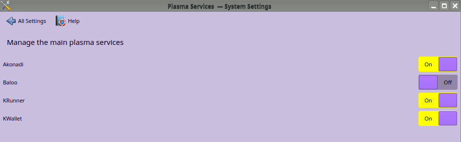

Did you enable Kwallet under the under the Plasma Services kcm as well as in the kwallet kcm?
I do believe that this may be causing your problem with this not sticking.
20th October 2016, 6:22
Thanks for your reply. Answer to both questions = Yes. Here's the pics [are any of my settings in either, wrong-looking to you?]:
