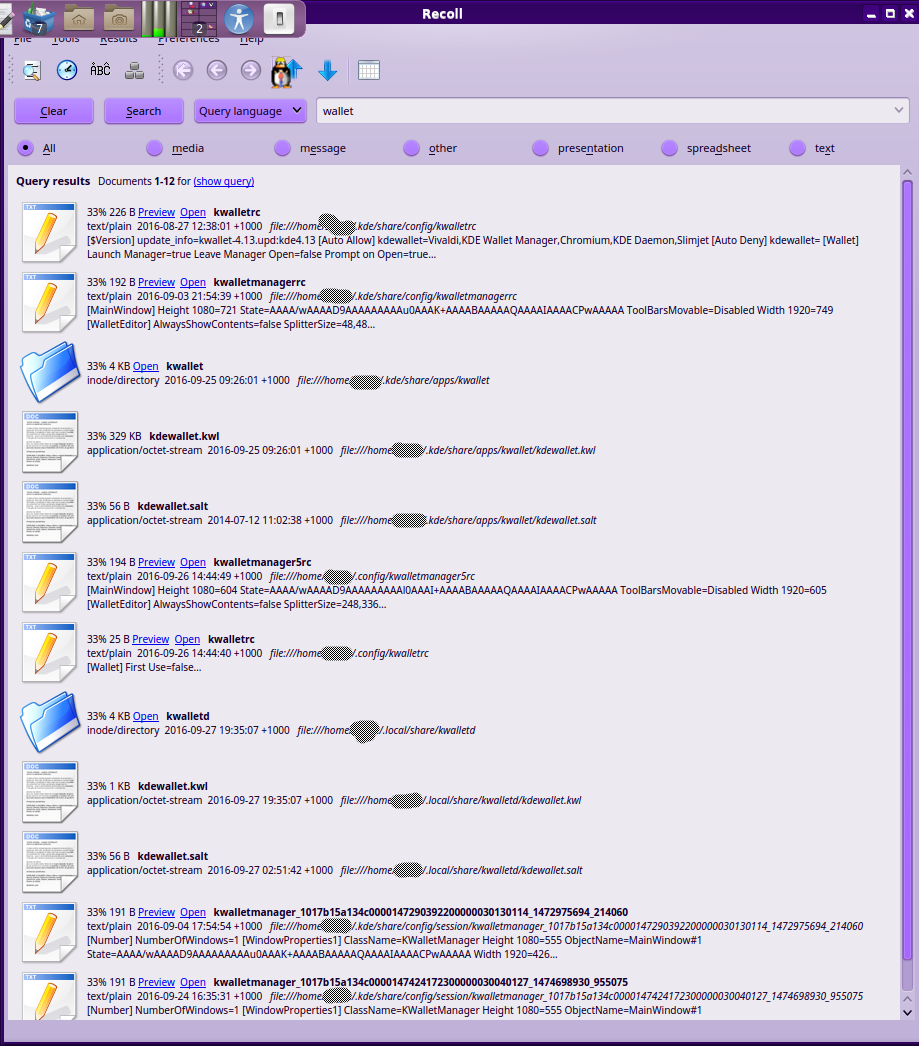

Following is the result of searching my /home for all instances of "wallet". I assume [but do not know] that some of these might be legacy from Mint KDE4, & others might be current from Maui Plasma5. I speculate [but again do not know] that Plasma5 probably does not read any folders that were from KDE4... but what if some of those folders are common to both DEs, & so now cause Plasma5 to be confused?
All suggestions & comments will be gratefully received by this confused little black duck.
