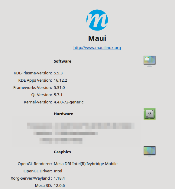

Thank you! I did try something else myself before I saw your reply: Before rebooting I used Synaptic directly to escape the console and I first checked plasma-desktop and plasma-desktop-data as well as maui-desktop for uninstall. Directly after this I checked them again for installation and then rebooted. After reboot I did not get any error message and system information looks like in the attached screenshot.
Is that fine?
How can I check with the command line, if everything went fine?
8th April 2017, 10:12
Yep if widgets appears in the big overlay launcher (kickerdash) then everything is fine Smile
