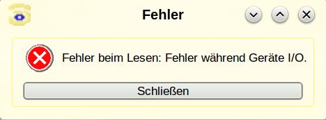

Xsane recognizes my scanner. But there is still a problem. Please have a look at the attached picture. When I have started Maui fresh I can scan the thumbnail. But when I try to start the real scan afterwards the attached notice appears: "Reading error. Error during device I/O". What can I do to make my scanner working again?

After start of Maui I can do 1 preview or 1 scan. Then I get the message about the error during device I/O. Afterwards I get this message immediately and no scanning I can do anymore. SANE version 1.0.27 is installed.

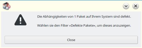

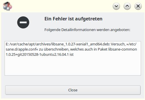

After a restart the update manager came with two updates. One was about SANE version 1.0.27. But I got an error message. Please have a look at Screenshot_1. I quit the update manager and initiated a restart. After restart the update manager still showed the availability of the update for SANE version 1.0.27. I started the procedure again. And I got the message shown in Screenshot_3. I closed the message and the installation procedure continued. Now there was no error message. I restarted the computer and XSANE is working fine. Is this a little bit weird?
