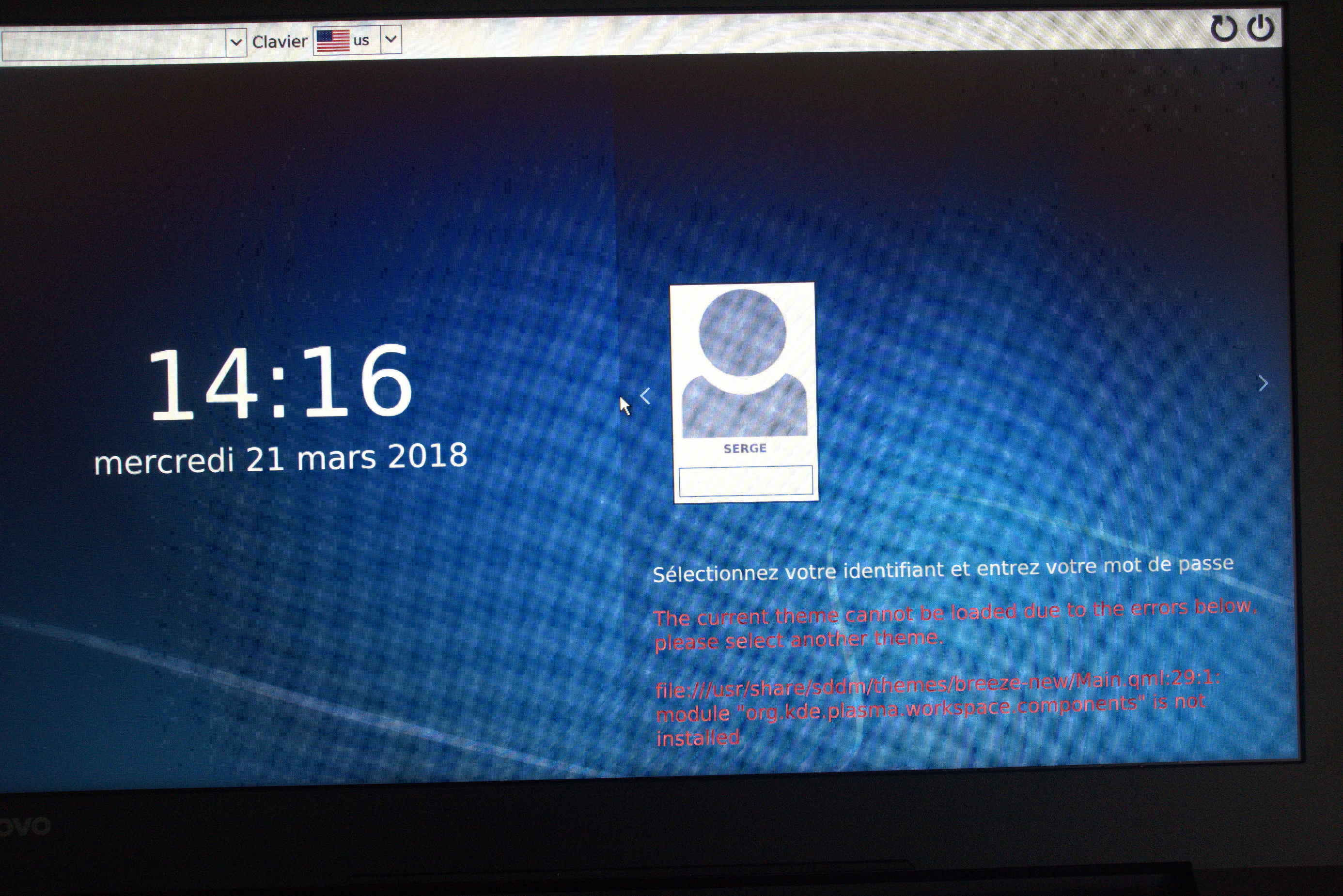

On two different machines I wanted to use the backport servers to update plasma from 5.10.2 to 5.12.3. in each case the download was OK. But at reboot I cant go further than the following screen.
See the attached file.
Any suggestions ?
Thanks
SM

Confirmed, do not update Maui 17.06 using xenial backport and neon backport.
The only sequence which worked was
5.10.2 to 5.11.3 to 5.12.1 then 5.12.2 and 5.12.3.
SM

(22nd March 2018, 9:39)smoreau Wrote: Confirmed, do not update Maui 17.06 using xenial backport and neon backport.
SM
See below the message at the end of the installation process.
SM

sudo apt-get install -f resolved the problem after the installation.
SM
