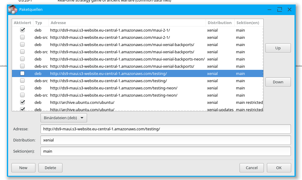

We uploaded a fixed version of samba-mounter to our testing repos. If you would be so kind to test this.
To do so activate the outcommented testing repo either with synaptic or by editing /etc/apt/sources.list.d/official-package-repositories.list .
For the Synaptic way open it up click on settings in the menu and choose repositories activate the testing one as seen on the screenshot.
Then update samba-mounter packages. It is advised to deactivate the testing repo afterwards.
