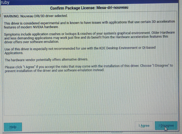

This additional info might be important. When i did the oS TW installation those several weeks ago, its Ruby Installer initially startled me with this:
As per my captured mouse position, i chose to go with the emulation rather than "real" driver... could this be a big factor in why TW is solid but Maui is fragile [KWin]?
