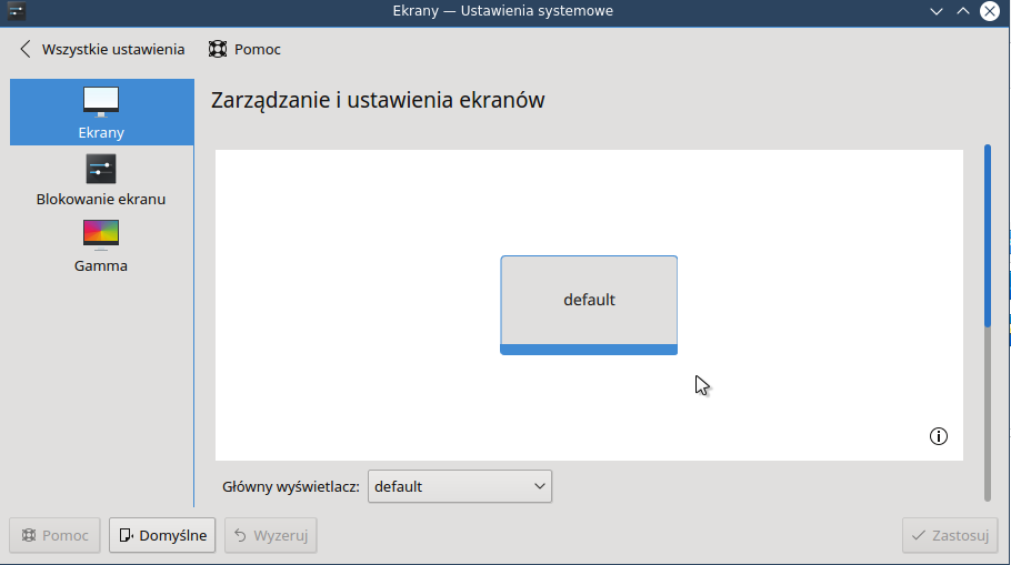

I have resolution options in screen dialog option in syscenter, but i cant set proper reselution for my laptop.

26th July 2017, 21:38
So what resolution are you missing from the systemsettings?
