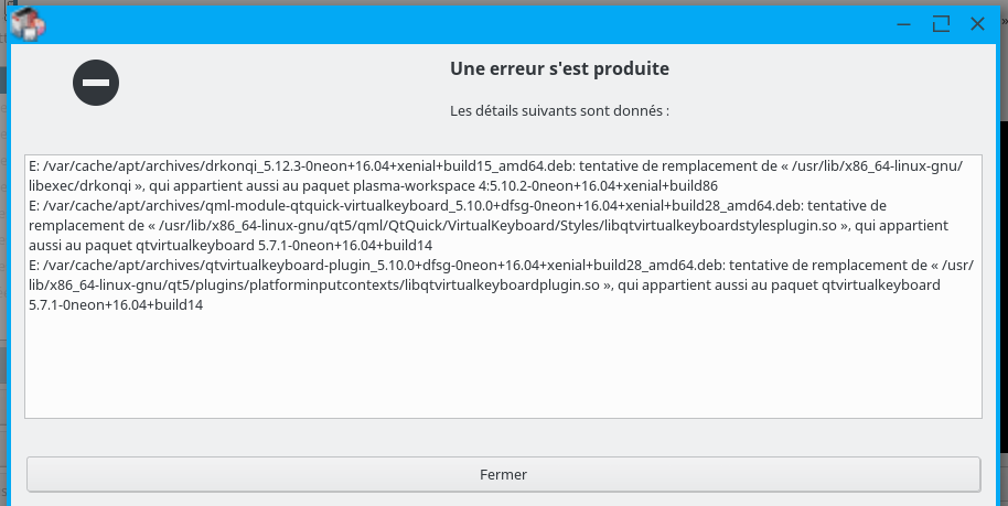

On two different machines I wanted to use the backport servers to update plasma from 5.10.2 to 5.12.3. in each case the download was OK. But at reboot I cant go further than the following screen.
See the attached file.
Any suggestions ?
Thanks
SM

See below the message at the end of the installation process.
SM

29th March 2018, 11:59
sudo apt-get install -f resolved the problem after the installation.
SM
